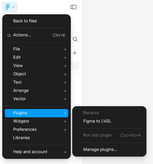

To install the Figma to LVGL Plugin, go to the Figma menu -> Plugins -> Manage plugins and find it in the list.
Figma to LVGL Installation
Click "Manage Plugins ..." to find and install Figma to LVGL
If you used it earlier, it will appear among the "Recents".

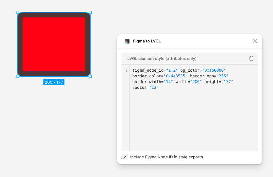

Once it's installed, a small window will appear showing the style properties of the selected element.
Figma to LVGL listing style properties of the selected UI element

The style properties listed by the plugin can be copy-pasted into any XML style section. For example:
<component>
  <styles>
     <style name="style_from_figma"
            figma_node_id="1:2" bg_color="0xfb0000"
            border_color="0x4e3535"
            border_opa="255"
            border_width="14"
            width="200"
            height="177"
            radius="13"
  </styles>
  <view>
     <style name="style_from_figma" />
  </view>
</component>
