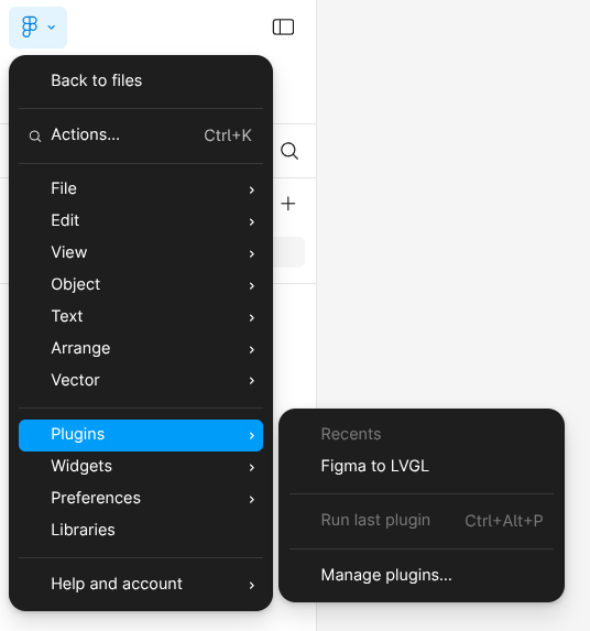

The Figma to LVGL Plugin is available publicly in Figma's plugin store and can be added to both public and private projects, even without a Figma subscription.
To install the Figma to LVGL Plugin, go to the Figma menu -> Plugins -> Manage plugins and find it in the list.
Click "Manage Plugins ..." to find and install Figma to LVGL¶
If you used it earlier, it will appear among the "Recents".

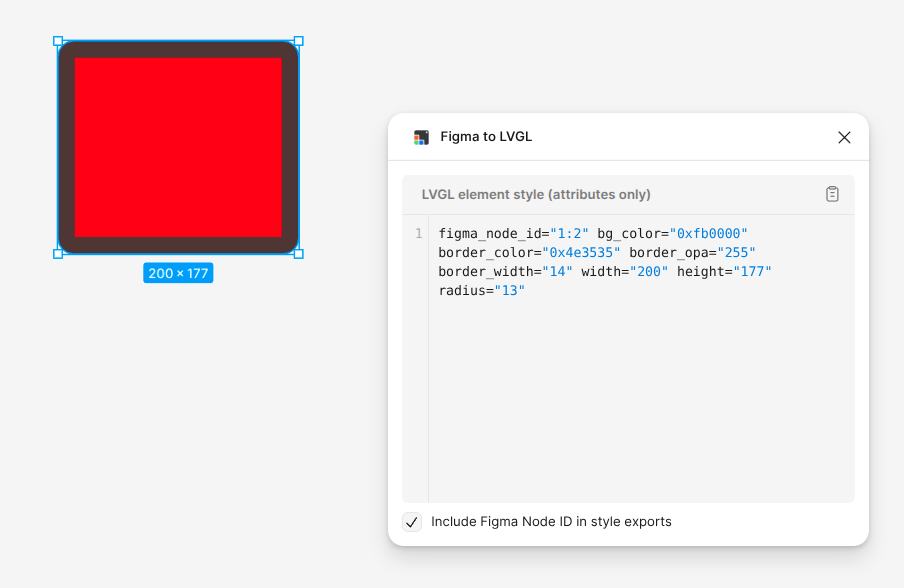

Once it's installed, a small window will appear showing the style properties of the selected element.
Figma to LVGL listing style properties of the selected UI element¶

The style properties listed by the plugin can be copy-pasted into any XML style section. For example:
<component>
<styles>
<style name="style_from_figma"
figma_node_id="1:2" bg_color="0xfb0000"
border_color="0x4e3535"
border_opa="255"
border_width="14"
width="200"
height="177"
radius="13"
</styles>
<view>
<style name="style_from_figma" />
</view>
</component>
