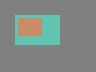

Moving together¶
If the position of a parent changes, the children will move along with it. Therefore, all positions are relative to the parent.
lv_obj_t * parent = lv_obj_create(lv_screen_active()); /* Create a parent Widget on current Screen */
lv_obj_set_size(parent, 100, 80); /* Set size of parent */
lv_obj_t * widget1 = lv_obj_create(parent); /* Create a Widget on previously created parent Widget */
lv_obj_set_pos(widget1, 10, 10); /* Set position of new Widget */

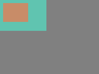

Modify the position of the parent:
lv_obj_set_pos(parent, 50, 50); /* Move the parent. The child will move with it. */
(For simplicity the adjusting of colors of the Widgets is not shown in the example.)

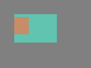

Visibility only on the parent¶
If a child is partially or fully outside its parent then the parts outside will not be visible.
lv_obj_set_x(widget1, -30); /* Move the child a little bit off the parent */
This behavior can be overwritten with lv_obj_add_flag(widget, LV_OBJ_FLAG_OVERFLOW_VISIBLE) which allows the children to be drawn outside of the parent. In addition to this, you must register the following event callback (this was not required in previous versions).
