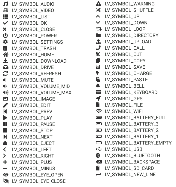

In addition to the ASCII range, the following symbols are also added to the built-in fonts from the FontAwesome font.
The symbols can be used singly as:
lv_label_set_text(my_label, LV_SYMBOL_OK);
Or together with strings (compile time string concatenation):
lv_label_set_text(my_label, LV_SYMBOL_OK "Apply");
Or more symbols together:
lv_label_set_text(my_label, LV_SYMBOL_OK LV_SYMBOL_WIFI LV_SYMBOL_PLAY);

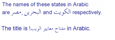

Arabic and Persian support¶
There are some special rules to display Arabic and Persian characters: the form of a character depends on its position in the text. A different form of the same letter needs to be used when it is isolated, at start, middle or end positions. Besides these, some conjunction rules should also be taken into account.
LVGL supports these rules if LV_USE_ARABIC_PERSIAN_CHARS
is enabled
in lv_conf.h
