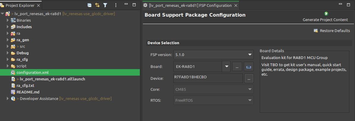

File->Import projectand selectGeneral/Existing projects into workspaceBrowse the cloned folder and press
Finish.Double click on
configuration.xml. This will activate theConfiguration Window.Renesas' Flexible Software Package (FSP) includes BSP and HAL layer support extended with multiple RTOS variants and other middleware stacks. The components will be available via code generation, including the entry point of "main.c".
