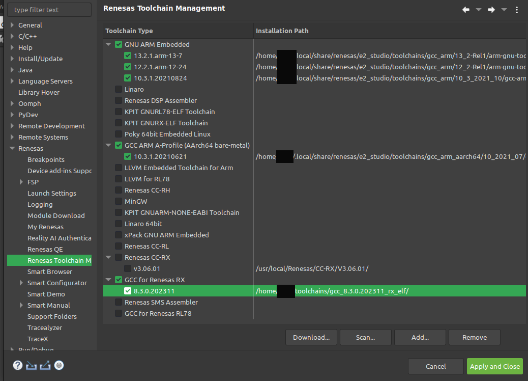

RX72 requires an external compiler for the RXv3 core. A free and open-source version is available here after a registration.
The compiler must be activated in e² studio:
Go to go to
Help->Add Renesas ToolchainsPress the
Add...buttonBrowse the installation folder of the toolchain

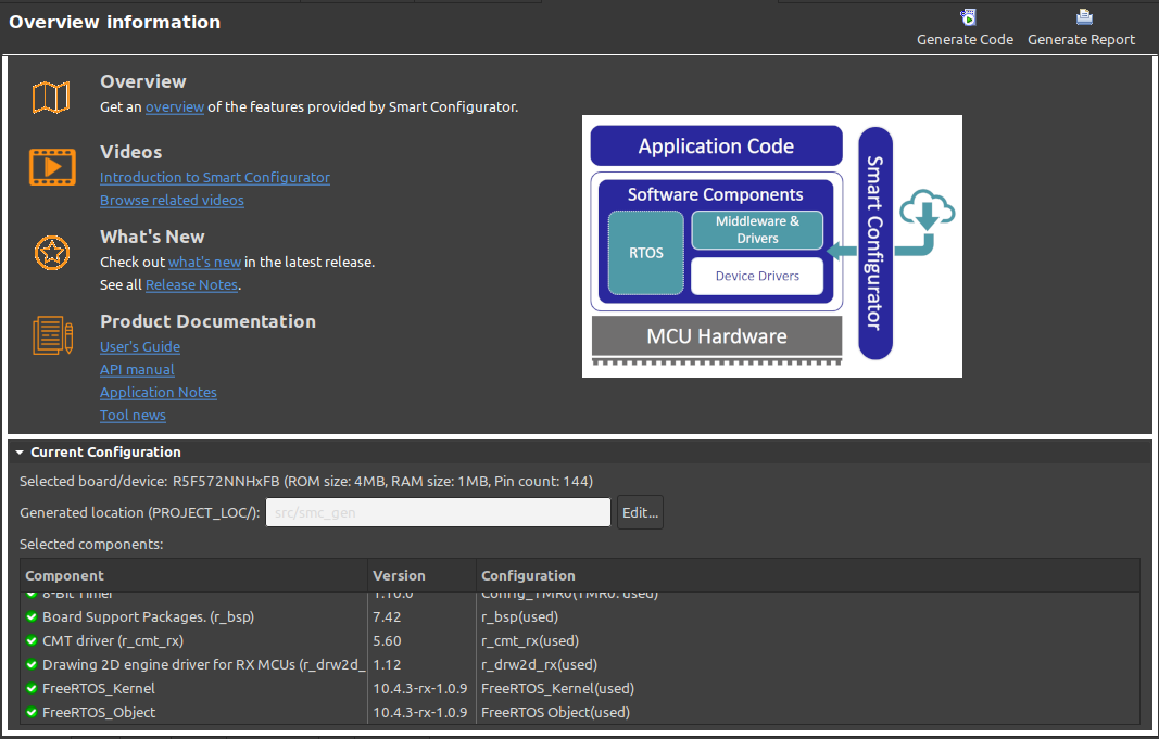

RX72N_EnVision_LVGL.scfg. This will activate theConfiguration Window.Renesas' Smart Configurator (SMC) includes BSP and HAL layer support extended with multiple RTOS variants and other middleware stacks. The components will be available via code generation, including the entry point of the application.
Press
Generate Codein the top right corner.

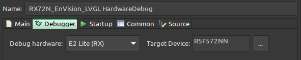

Ctrl+Alt+BClick the Debug button (
). If prompted with Debug Configurations, on theDebuggertab select theE2 LiteasDebug hardwareandR5F572NNasTarget Device:
Note
Make sure that both channels of SW1 DIP switch (next to ECN1) are OFF.
