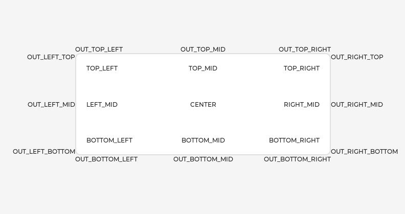

9 convenient "anchors" can be used with these functions:
See illustration below to visualize what these mean.

Relative to another Widget¶
Alternately, you can choose an "anchor" on another Widget.
lv_obj_align_to(widget, reference_widget, align, x, y);
where align can be done of the following:
Example: to horizontally center a label 10 pixels above a button:
lv_obj_align_to(label, btn, LV_ALIGN_OUT_TOP_MID, 0, -10);
Note that, unlike with lv_obj_align(), lv_obj_align_to()
does not remember the "anchor" used, and so will not automatically reposition
the aligned widget if the reference widget later moves.
The following illustration shows the meaning of each "anchor" mentioned above.
