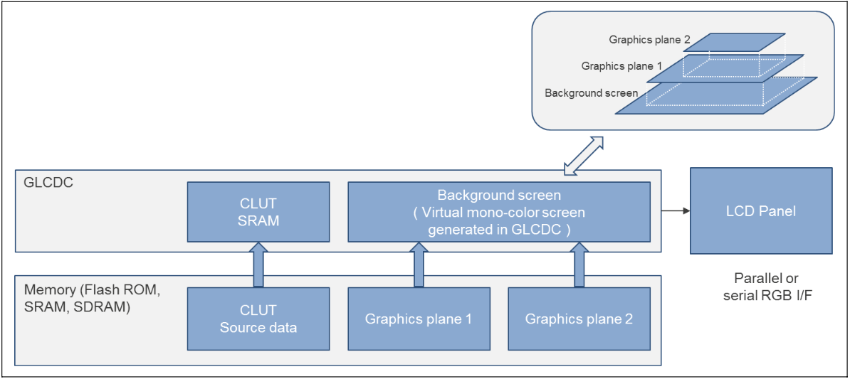

GLCDC is a multi-stage graphics output peripheral used in Renesas MCUs. It is designed to automatically generate timing and data signals for different LCD panels.
Supports LCD panels with RGB interface (up to 24 bits) and sync signals (HSYNC, VSYNC and Data Enable optional)
Supports various color formats for input graphics planes (RGB888, ARGB8888, RGB565, ARGB1555, ARGB4444, CLUT8, CLUT4, CLUT1)
Supports the Color Look-Up Table (CLUT) usage for input graphics planes (ARGB8888) with 512 words (32 bits/word)
Supports various color formats for output (RGB888, RGB666, RGB565, Serial RGB888)
Can input two graphics planes on top of the background plane and blend them on the screen
Generates a dot clock to the panel. The clock source is selectable from internal or external (LCD_EXTCLK)
Supports brightness adjustment, contrast adjustment, and gamma correction
Supports GLCDC interrupts to handle frame-buffer switching or underflow detection
