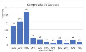

Most screenshot and UI images (where there are a limited number of colors) can be compressed to save more than 70% space. The below statistics are from a watch project. It shows the file count of every compress level. For rare conditions, RLE compress may increase the file size if there's no large repetition in data.
