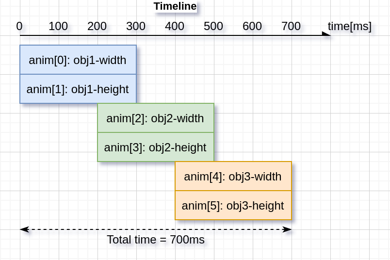

Timeline¶
You can create a series of related animations that are linked together using an Animation Timeline. A Timeline is a collection of multiple Animations which makes it easy to create complex composite Animations. To create and use an Animation Timeline:
Create an Animation template but do not call
lv_anim_start()on it.Create an Animation Timeline object by calling
lv_anim_timeline_create().Add Animation templates to the Timeline by calling lv_anim_timeline_add(timeline, start_time, &anim_template).
start_timeis the start time of the Animation on the Timeline. Note thatstart_timewill override any value given to lv_anim_set_delay(&anim_template, delay).Call lv_anim_timeline_start(timeline) to start the Animation Timeline.
Note
lv_anim_timeline_add(timeline, start_time, &anim_template) makes its own copy of the contents of the Animation template, so if you do not need it later, its contents do not need to be preserved after this call.
It supports forward and reverse play of the entire Animation group, using lv_anim_timeline_set_reverse(timeline, reverse). Note that if you want to play in reverse from the end of the Timeline, you need to call lv_anim_timeline_set_progress(timeline, LV_ANIM_TIMELINE_PROGRESS_MAX) after adding all Animations and before telling it to start playing.
Call lv_anim_timeline_pause(timeline) to pause the Animation Timeline. Note: this does not preserve its state. The only way to start it again is to call lv_anim_timeline_start(timeline), which starts the Timeline from the beginning or at the point set by lv_anim_timeline_set_progress(timeline, progress).
Call lv_anim_timeline_set_progress(timeline, progress) function to set the
state of the Animation Timeline according to the progress value. progress is
a value between 0 and 32767 (LV_ANIM_TIMELINE_PROGRESS_MAX) to indicate the
proportion of the Timeline that has "played". Example: a progress value of
LV_ANIM_TIMELINE_PROGRESS_MAX / 2 would set the Timeline play to its
half-way point.
Call lv_anim_timeline_get_playtime(timeline) function to get the total duration (in milliseconds) of the entire Animation Timeline.
Call lv_anim_timeline_get_reverse(timeline) function to get whether the Animation Timeline is also played in reverse after its forward play completes.
Call lv_anim_timeline_delete(timeline) function to delete the Animation Timeline. Note: If you need to delete a Widget during Animation, be sure to delete the Animation Timeline before deleting the Widget. Otherwise, the program may crash or behave abnormally.

Animation timeline¶
C code
View on GitHub#include "../lv_examples.h"
#if LV_USE_FLEX && LV_BUILD_EXAMPLES
static const int32_t obj_width = 90;
static const int32_t obj_height = 70;
static void set_width(lv_anim_t * var, int32_t v)
lv_obj_set_width((lv_obj_t *) var->var, v);
static void set_height(lv_anim_t * var, int32_t v)
lv_obj_set_height((lv_obj_t *) var->var, v);
static void set_slider_value(lv_anim_t * var, int32_t v)
lv_slider_set_value((lv_obj_t *) var->var, v, LV_ANIM_OFF);
static void btn_start_event_handler(lv_event_t * e)
lv_obj_t * btn = lv_event_get_current_target_obj(e);
lv_anim_timeline_t * anim_timeline = (lv_anim_timeline_t *) lv_event_get_user_data(e);
bool reverse = lv_obj_has_state(btn, LV_STATE_CHECKED);
lv_anim_timeline_set_reverse(anim_timeline, reverse);
lv_anim_timeline_start(anim_timeline);
static void btn_pause_event_handler(lv_event_t * e)
lv_anim_timeline_pause(anim_timeline);
static void slider_prg_event_handler(lv_event_t * e)
lv_obj_t * slider = lv_event_get_current_target_obj(e);
int32_t progress = lv_slider_get_value(slider);
lv_anim_timeline_set_progress(anim_timeline, (uint16_t) progress);
* Create an animation timeline
void lv_example_anim_timeline_1(void)
/* Create anim timeline */
lv_anim_timeline_t * anim_timeline = lv_anim_timeline_create();
lv_obj_t * par = lv_screen_active();
lv_obj_set_flex_flow(par, LV_FLEX_FLOW_ROW);
lv_obj_set_flex_align(par, LV_FLEX_ALIGN_SPACE_AROUND, LV_FLEX_ALIGN_CENTER, LV_FLEX_ALIGN_CENTER);
/* create btn_start */
lv_obj_t * btn_start = lv_button_create(par);
lv_obj_add_event_cb(btn_start, btn_start_event_handler, LV_EVENT_VALUE_CHANGED, anim_timeline);
lv_obj_add_flag(btn_start, LV_OBJ_FLAG_IGNORE_LAYOUT);
lv_obj_add_flag(btn_start, LV_OBJ_FLAG_CHECKABLE);
lv_obj_align(btn_start, LV_ALIGN_TOP_MID, -100, 20);
lv_obj_t * label_start = lv_label_create(btn_start);
lv_label_set_text(label_start, "Start");
lv_obj_center(label_start);
/* create btn_pause */
lv_obj_t * btn_pause = lv_button_create(par);
lv_obj_add_event_cb(btn_pause, btn_pause_event_handler, LV_EVENT_CLICKED, anim_timeline);
lv_obj_add_flag(btn_pause, LV_OBJ_FLAG_IGNORE_LAYOUT);
lv_obj_align(btn_pause, LV_ALIGN_TOP_MID, 100, 20);
lv_obj_t * label_pause = lv_label_create(btn_pause);
lv_label_set_text(label_pause, "Pause");
lv_obj_center(label_pause);
/* create slider_prg */
lv_obj_t * slider_prg = lv_slider_create(par);
lv_obj_add_event_cb(slider_prg, slider_prg_event_handler, LV_EVENT_VALUE_CHANGED, anim_timeline);
lv_obj_add_flag(slider_prg, LV_OBJ_FLAG_IGNORE_LAYOUT);
lv_obj_align(slider_prg, LV_ALIGN_BOTTOM_MID, 0, -20);
lv_slider_set_range(slider_prg, 0, LV_ANIM_TIMELINE_PROGRESS_MAX);
/* create 3 objects */
lv_obj_t * obj1 = lv_obj_create(par);
lv_obj_set_size(obj1, obj_width, obj_height);
lv_obj_set_scrollbar_mode(obj1, LV_SCROLLBAR_MODE_OFF);
lv_obj_t * obj2 = lv_obj_create(par);
lv_obj_set_size(obj2, obj_width, obj_height);
lv_obj_set_scrollbar_mode(obj2, LV_SCROLLBAR_MODE_OFF);
lv_obj_t * obj3 = lv_obj_create(par);
lv_obj_set_size(obj3, obj_width, obj_height);
lv_obj_set_scrollbar_mode(obj3, LV_SCROLLBAR_MODE_OFF);
/* anim-slider */
lv_anim_t a_slider;
lv_anim_init(&a_slider);
lv_anim_set_var(&a_slider, slider_prg);
lv_anim_set_values(&a_slider, 0, LV_ANIM_TIMELINE_PROGRESS_MAX);
lv_anim_set_custom_exec_cb(&a_slider, set_slider_value);
lv_anim_set_path_cb(&a_slider, lv_anim_path_linear);
lv_anim_set_duration(&a_slider, 700);
/* anim-obj1 */
lv_anim_t a1;
lv_anim_init(&a1);
lv_anim_set_var(&a1, obj1);
lv_anim_set_values(&a1, 0, obj_width);
lv_anim_set_custom_exec_cb(&a1, set_width);
lv_anim_set_path_cb(&a1, lv_anim_path_overshoot);
lv_anim_set_duration(&a1, 300);
lv_anim_t a2;
lv_anim_init(&a2);
lv_anim_set_var(&a2, obj1);
lv_anim_set_values(&a2, 0, obj_height);
lv_anim_set_custom_exec_cb(&a2, set_height);
lv_anim_set_path_cb(&a2, lv_anim_path_ease_out);
lv_anim_set_duration(&a2, 300);
/* anim-obj2 */
lv_anim_t a3;
lv_anim_init(&a3);
lv_anim_set_var(&a3, obj2);
lv_anim_set_values(&a3, 0, obj_width);
lv_anim_set_custom_exec_cb(&a3, set_width);
lv_anim_set_path_cb(&a3, lv_anim_path_overshoot);
lv_anim_set_duration(&a3, 300);
lv_anim_t a4;
lv_anim_init(&a4);
lv_anim_set_var(&a4, obj2);
lv_anim_set_values(&a4, 0, obj_height);
lv_anim_set_custom_exec_cb(&a4, set_height);
lv_anim_set_path_cb(&a4, lv_anim_path_ease_out);
lv_anim_set_duration(&a4, 300);
/* anim-obj3 */
lv_anim_t a5;
lv_anim_init(&a5);
lv_anim_set_var(&a5, obj3);

/* add animations to timeline */
lv_anim_timeline_add(anim_timeline, 0, &a_slider);
lv_anim_timeline_add(anim_timeline, 0, &a1);
lv_anim_timeline_add(anim_timeline, 0, &a2);
lv_anim_timeline_add(anim_timeline, 200, &a3);
lv_anim_timeline_add(anim_timeline, 200, &a4);
lv_anim_timeline_add(anim_timeline, 400, &a5);
lv_anim_timeline_add(anim_timeline, 400, &a6);
lv_anim_timeline_set_progress(anim_timeline, LV_ANIM_TIMELINE_PROGRESS_MAX);
